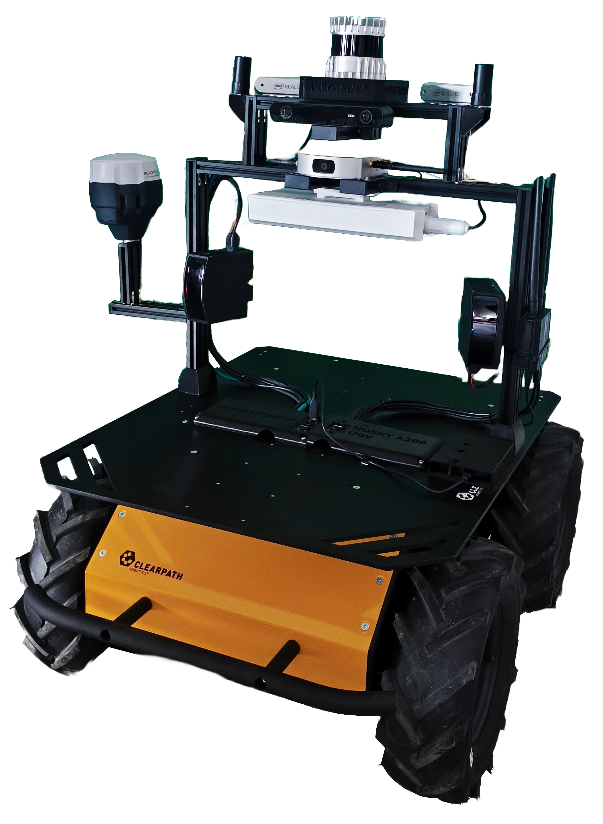

Husky GE
_images/husky.webp
This specifies the configuration for Husky GE.
Components
  1. Controller - SteamDeck Control
  2. Wireless Router - Telefonika 3G/4G
  3. Access Point - TP-Link AX-800
  4. Computer - NVIDIA Jetson AGX Orin
  5. IMU - Phidgets Spatial 3/3/3 Basic
  6. GPS - Fixposition
  7. GPS - EMLID REACH RS2+
  8. Lidar - Ouster OS1 32
  9. Lidar - RoboSense RS-LiDAR-M1 Plus x2
  10. Depth Camera - Stereolabs ZED 2i Depth Camera
  11. Depth Camera - Intel® RealSense Depth Camera D455 x2
  12. SSD - WD Elements 2TB

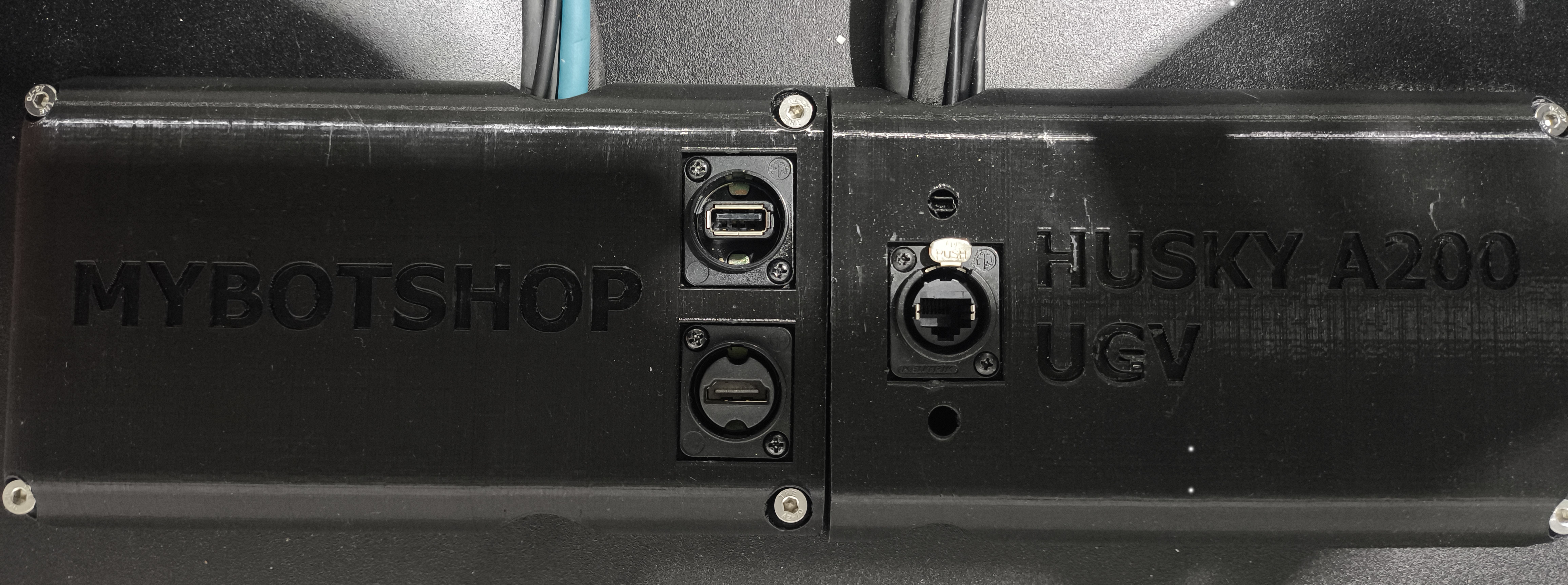

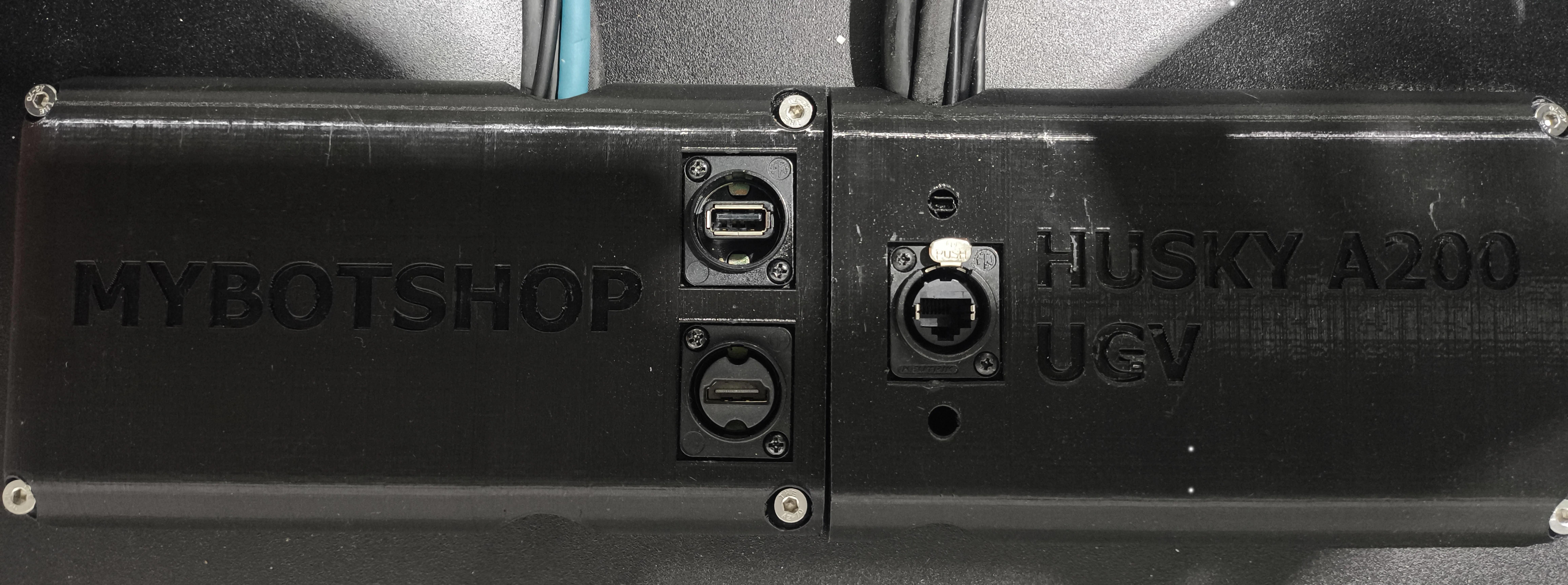

Ethernet port on Husky
The Ethernet port at the back of the Husky can be utilized for setting up communication via LAN.

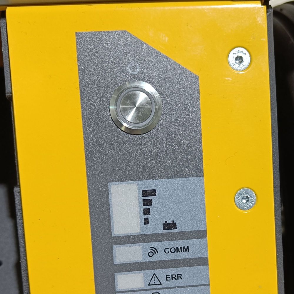

Power on

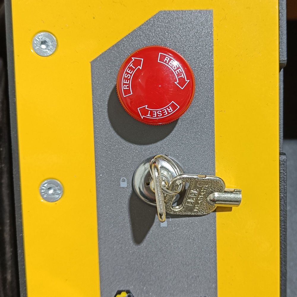

Emergency Switch Release
Charging Port
  1. Ensure the emergency button is released as well as the key is turned to the unlock position.
    • To check if the emergency switch is released, twist the switch in the indicated direction on it. If it pops up, then the switch has successfully been released.
    • If the robot light is yellow, it means that either the emergency switch is not released or the key is not turned or the battery is not correctly plugged in.
  2. Press the power button on the front of the husky. It has the power symbol as displayed.

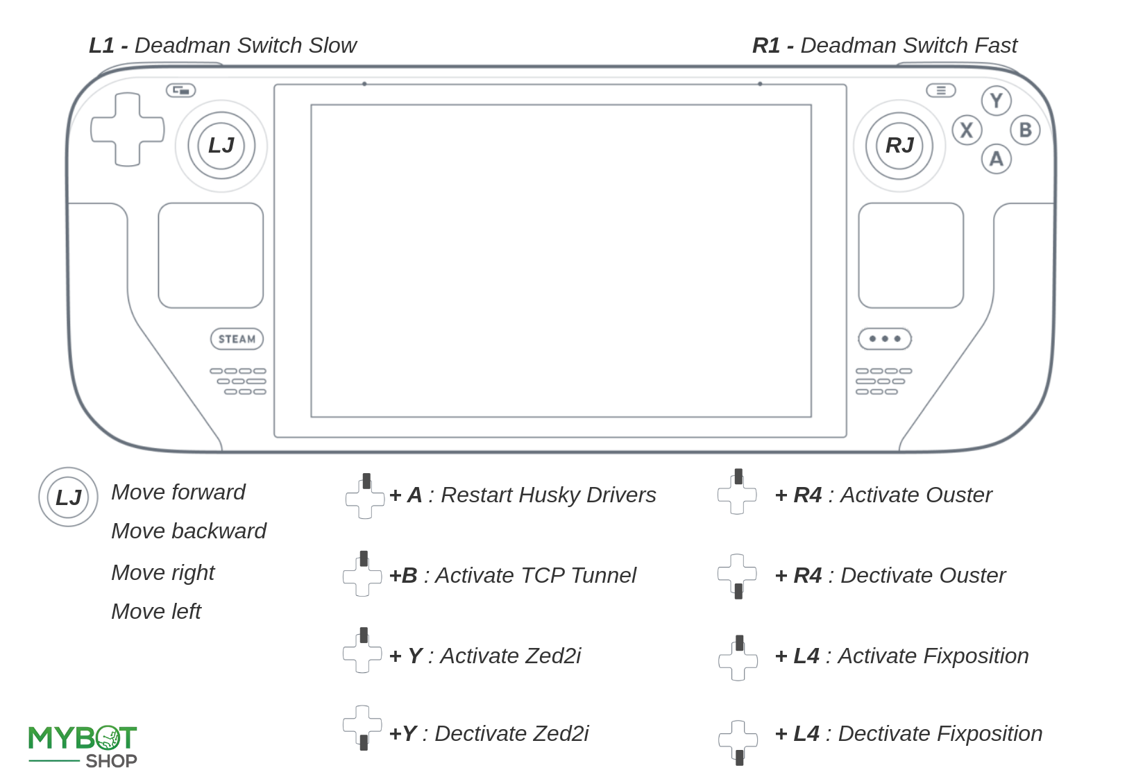

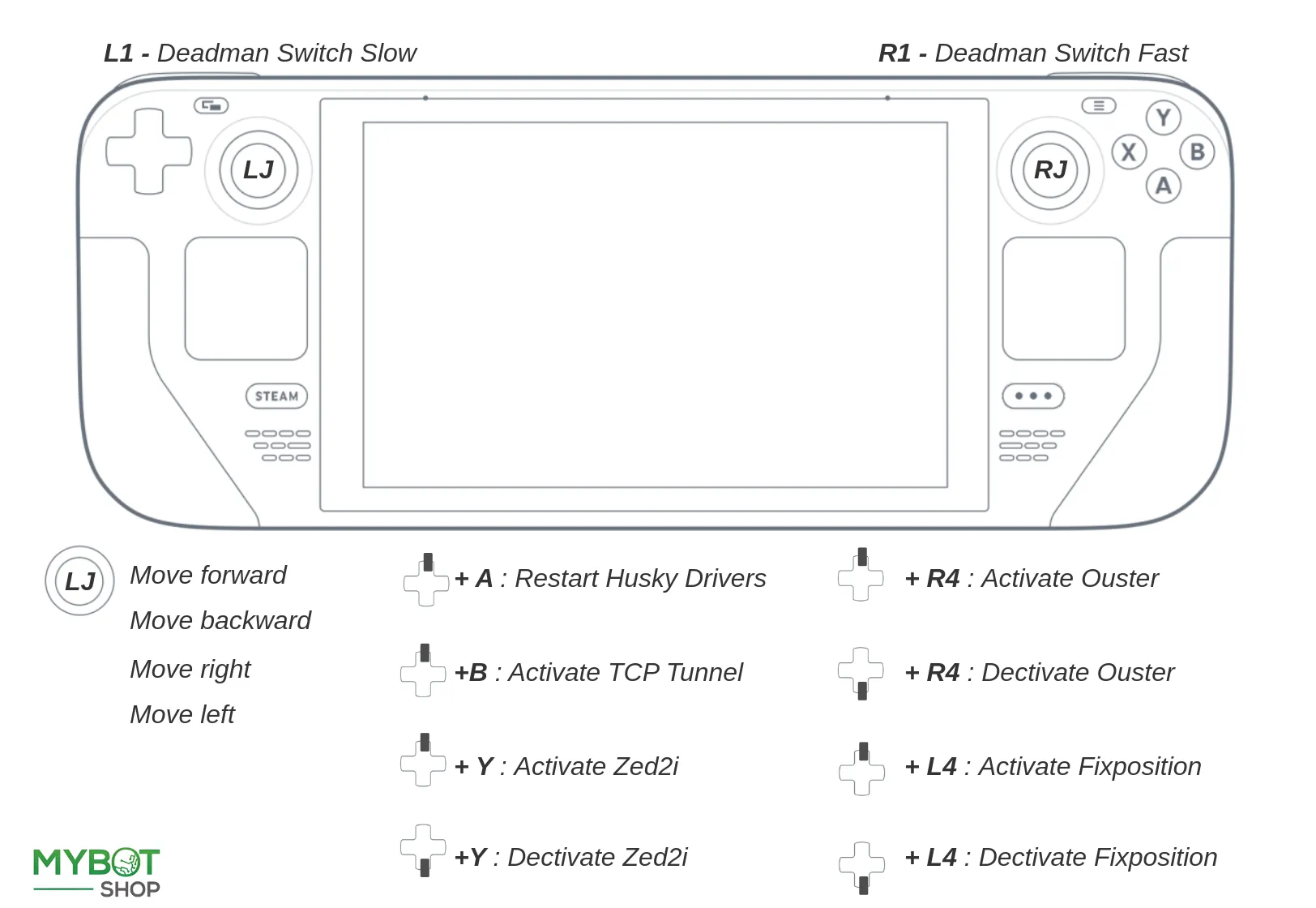

Steamdeck Controller | Teleop Control Joystick | Husky
Important
When launching the Joylauncher, do not touch any of the buttons until the steamdeck displays the robot is connected or not connected and also make sure to wait for 10-15 sec so that the steamdeck is connected with Husky Wifi before launching anything on steamdeck.
_images/steamdeck1.webp
The Steamdeck usage is in experimental phase. Loss of connection or (laggy connection) may lead to the robot moving and/or not stopping immediately. Caution should be taken when using the Steamdeck for the operation of the robot!

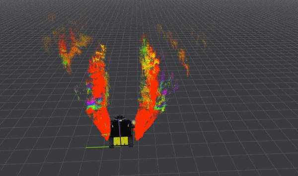

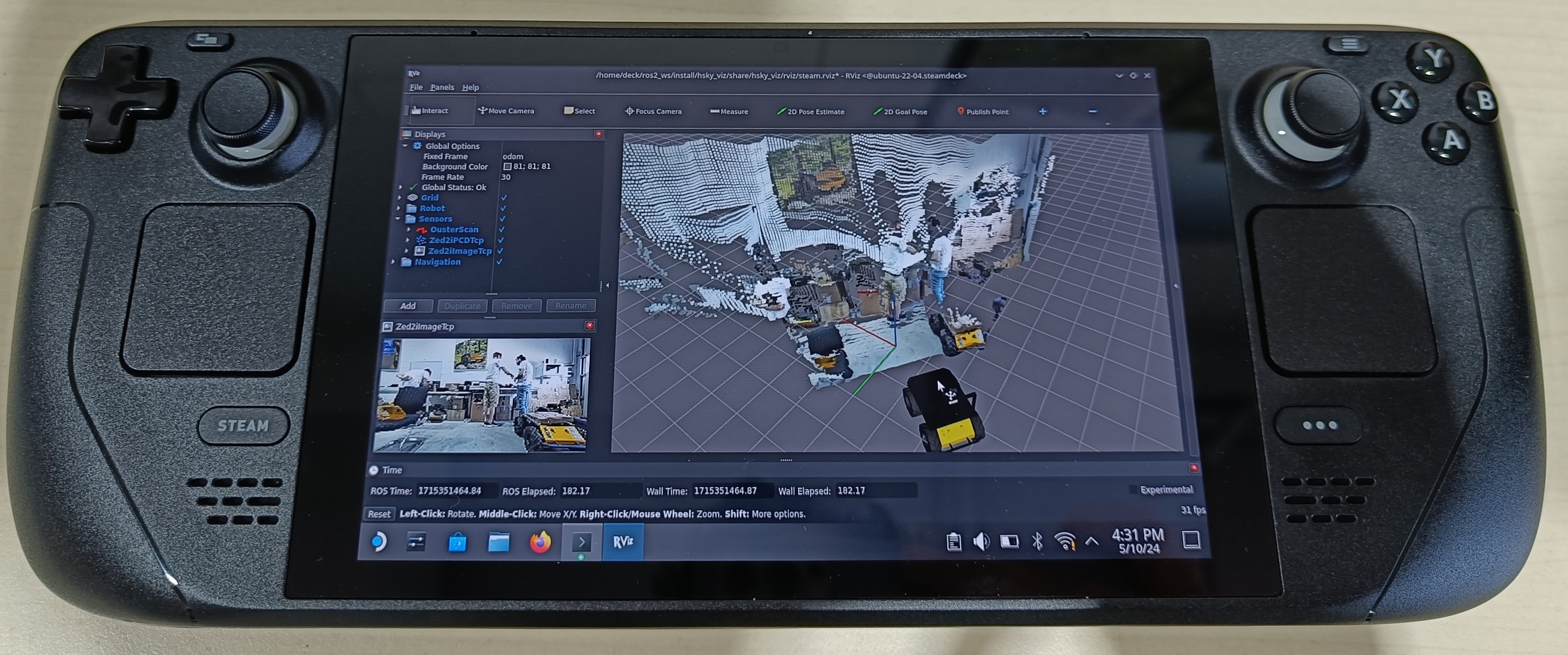

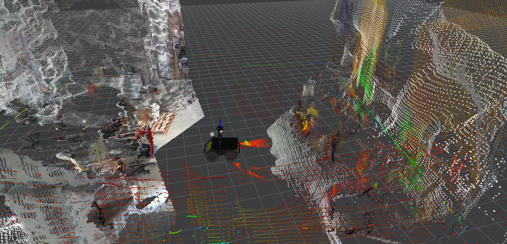

Digital Twin (RVIZ2)
To visualize the hsky, you can run:
ros2 launch hsky_viz view_robot.launch
_images/rviz2.webp
_images/viz.webp
Important
Please Activate TCP tunnel function by pressing B + Up arrow to see the Rviz digital twin as well as the data from all the sensors on steamdeck. If in case the Zed2i camera depth cloud, as well as the image, does not show then please first restart the husky driver reactivate TCP tunnel, and then reopen the visualizer on steamdeck.

Activation via steamdeck:
  1. L4 + Up arrow Activate Fixposition GPS.
  2. L4 + Down arrow Deactivate Fixposition GPS.
  1. R4 + Up arrow Activate Ouster Lidar.
  2. R4 + Down arrow Deactivate Ouster Lidar.
  1. L2 + Up arrow Activate Realsense-i Depth camera.
  2. L2 + Down arrow Deactivate Realsense-i Depth camera.
  3. R2 + Up arrow Activate Realsense-ii Depth camera.
  4. R2 + Down arrow Deactivate Realsense-ii Depth camera.
  1. L5 + Up arrow Activate Emlid RS2 GPS.
  2. L5 + Down arrow Deactivate Emlid RS2 GPS.
  1. Y + Up arrow Activate Zed2i Depth-Camera.
  2. Y + Down arrow Deactivate Zed2i Depth-Camera.
