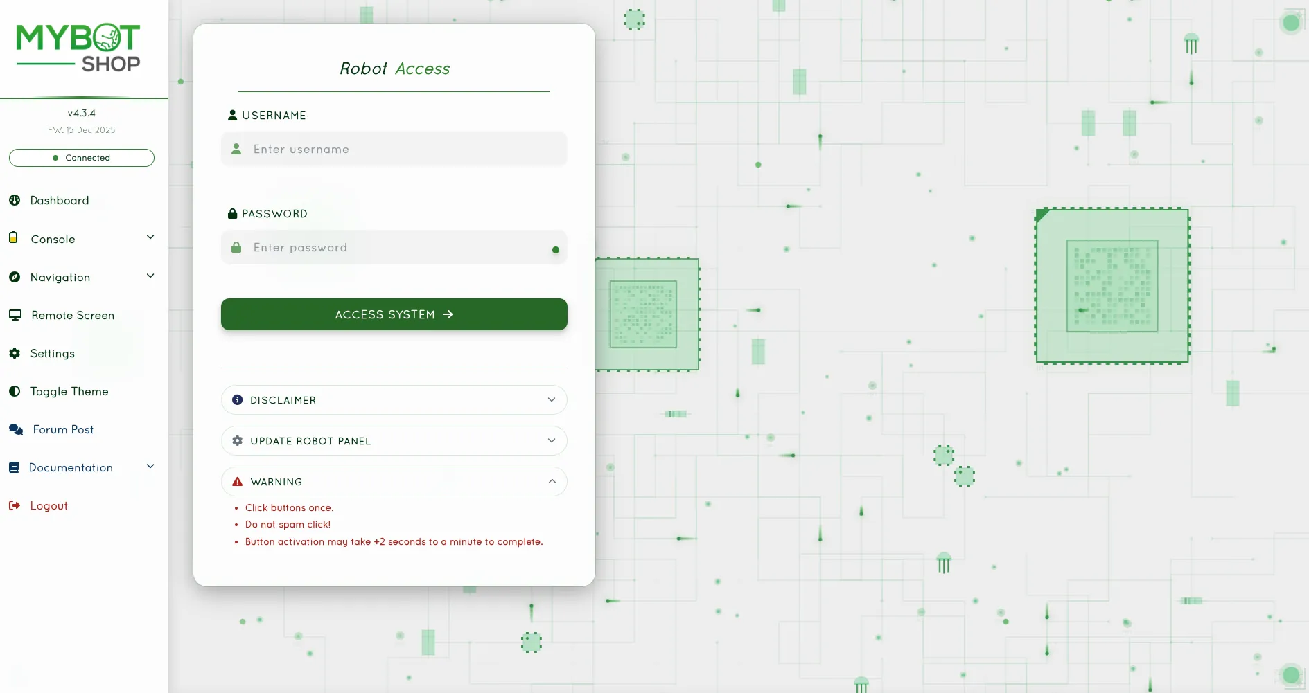

Default Credentials:
  • Username: admin
  • Password: mybotshop
Login
_images/web_login.webp
Webserver Login Page

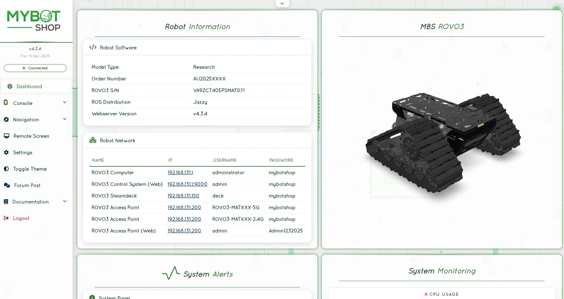

Dashboard
_images/web_dashboard.webp
Main Dashboard with 3D Robot Visualization

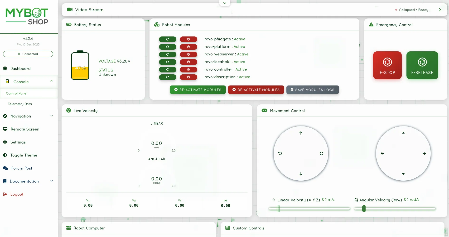

Features:
Feature
3D Visualization
Real-time robot model via GLTF
Joystick Teleop
Browser-based joystick control
Service Management
Start/stop ROS2 nodes and services
Map Visualization
View navigation maps
Battery Monitoring
Real-time battery state
GPS Waypoints
Record and manage GPS waypoints
Rosbag Recording
Start/stop rosbag recordings
VNC Access
Remote desktop via VNC

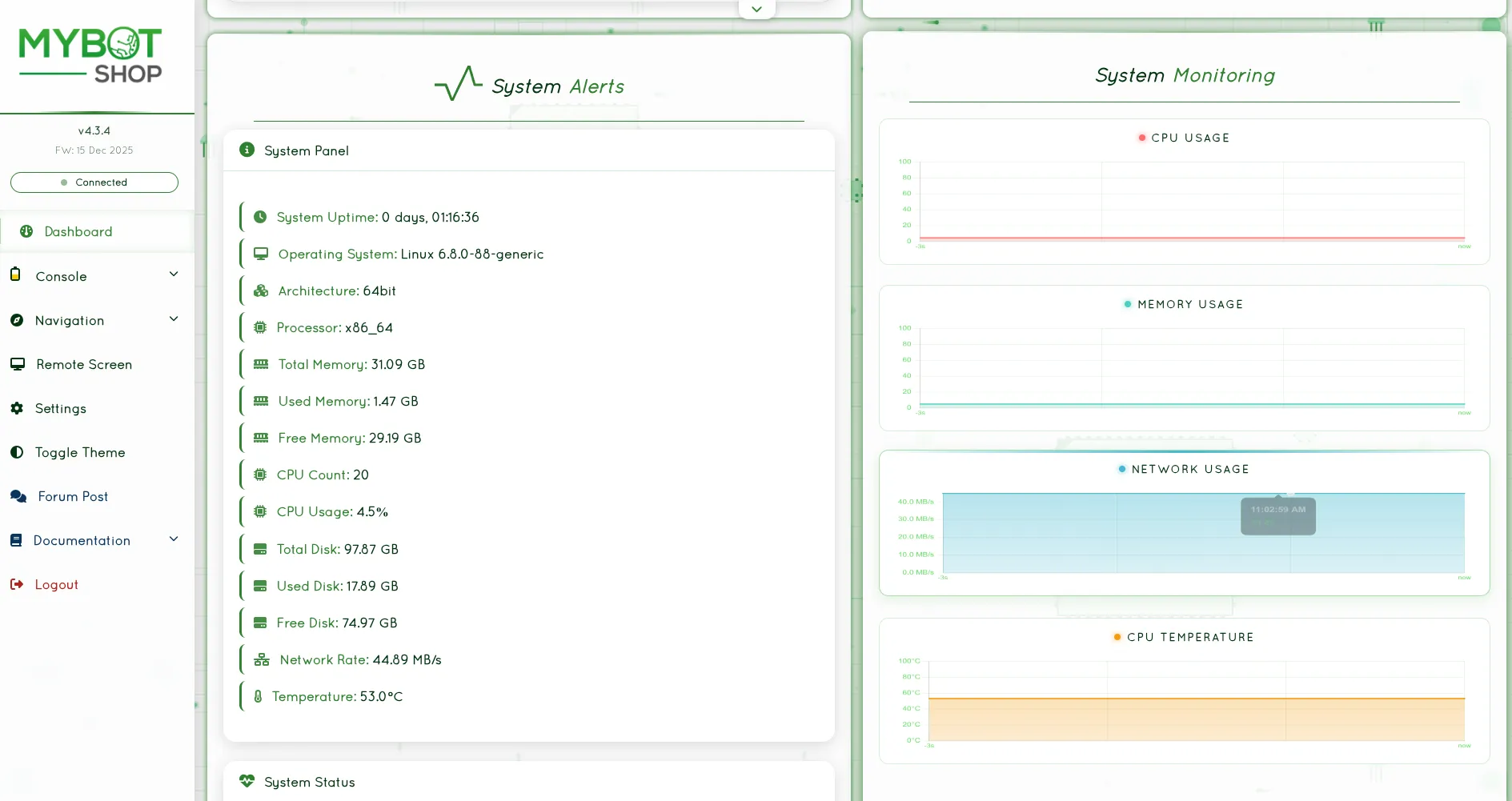

System Management
_images/web_system.webp
System Management Interface

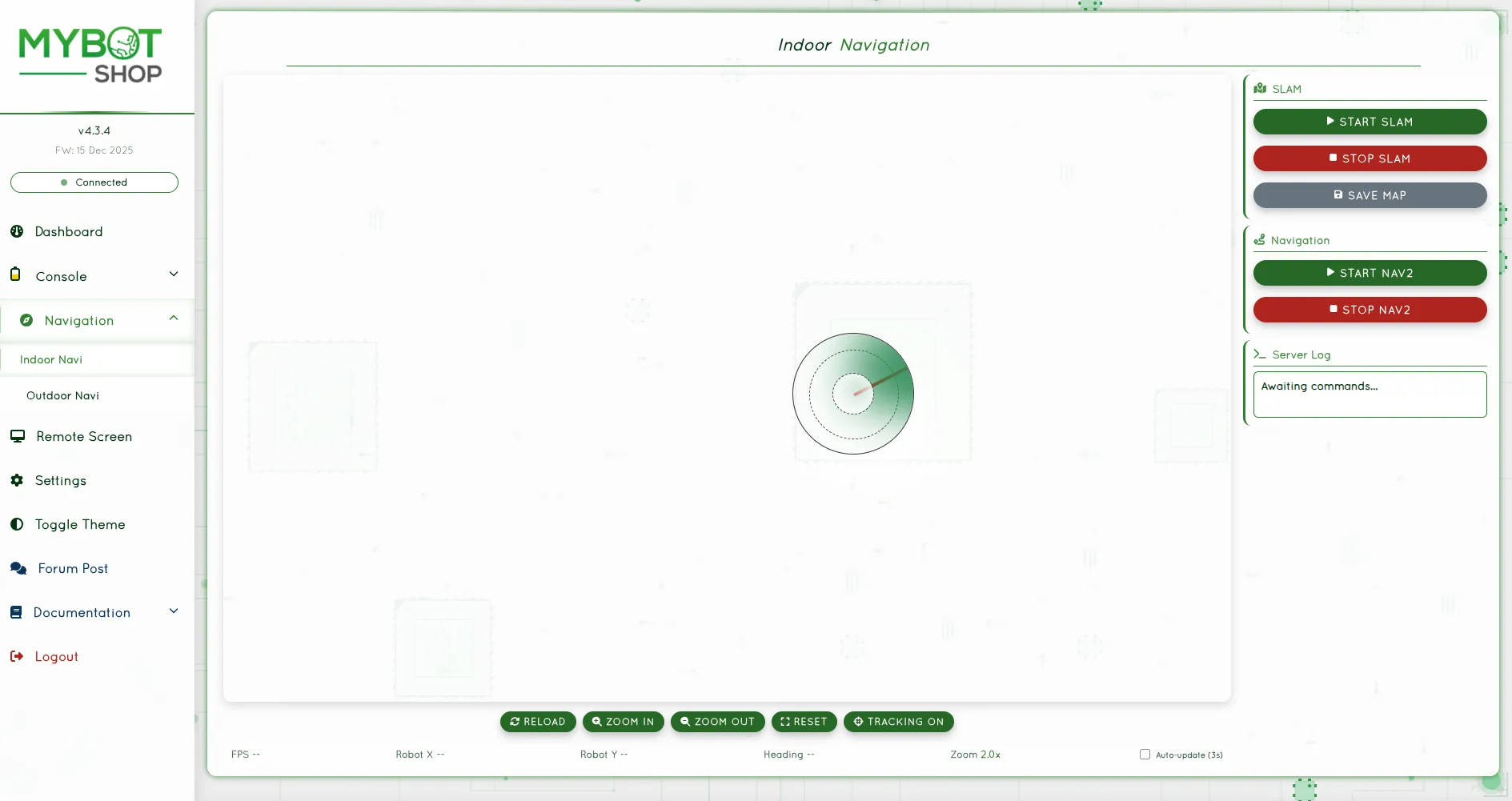

Indoor Navigation
_images/web_nav_indoor.webp
Indoor Navigation View

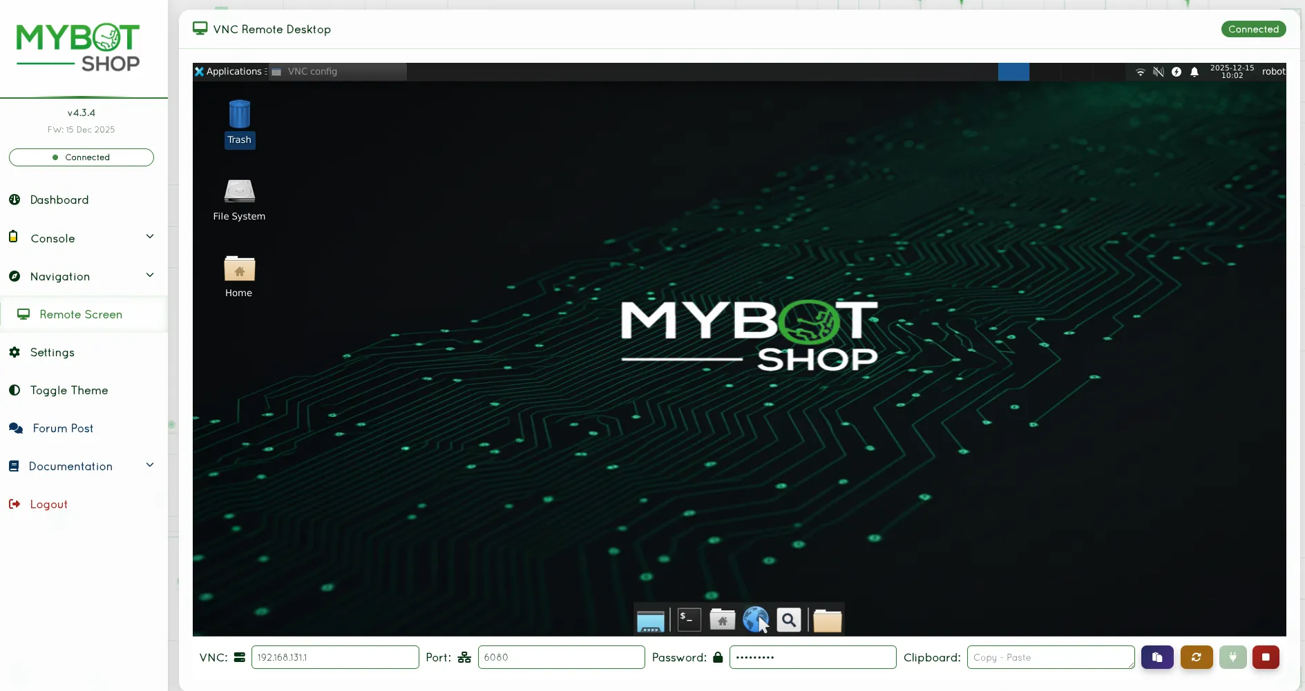

VNC Remote Desktop
_images/web_vnc.webp
VNC Remote Desktop Access

VNC Setup:
To enable VNC remote desktop:
vncpasswd ~/.vnc/passwd
# Password: mybotshop

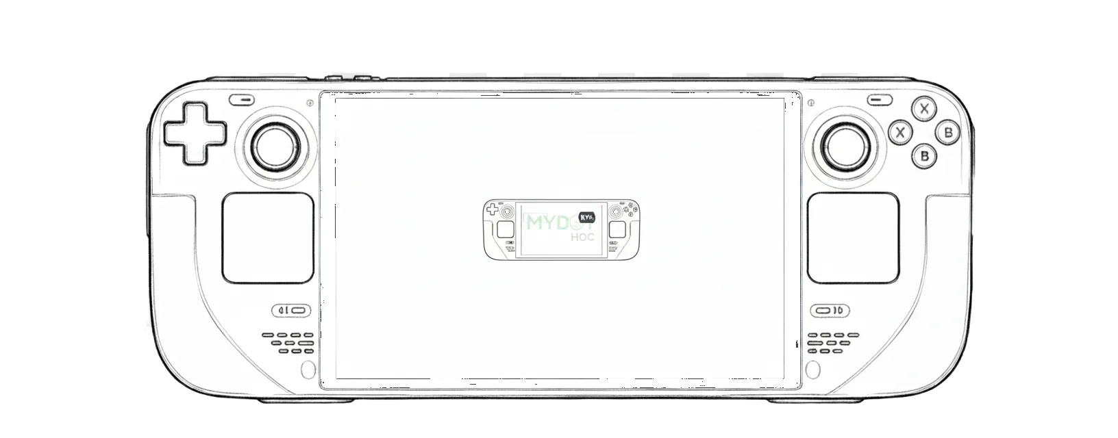

Steamdeck Control
The ROVO3 can be controlled via Steamdeck using the steamdeck_joy_teleop interface.
_images/steamdeck.webp
Steamdeck Controller Interface

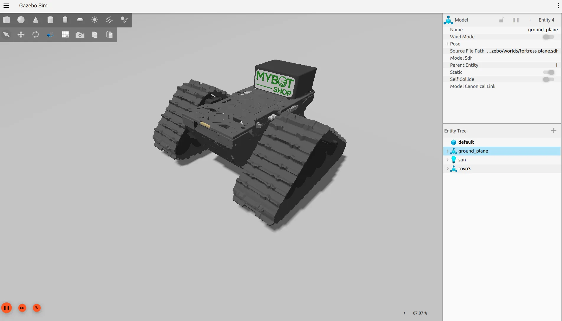

The ROVO3 uses Gazebo Harmonic for simulation, which is the recommended simulator for ROS2 Jazzy.
_images/rovo3_gazebo.webp
ROVO3 Simulation in Gazebo Harmonic

rovo_gazebo
Gazebo Harmonic simulation package for the ROVO3 platform.
Available Worlds:
  • fortress-plane.sdf - Flat ground plane (default)
  • fortress-substation.sdf - Industrial substation environment
  • fortress-moon.sdf - Lunar terrain
Simulated Topics (GZ -> ROS):
Topic
Type
/clock
rosgraph_msgs/Clock
Simulation time
/odom
nav_msgs/Odometry
Robot odometry
/sensors/imu/data
sensor_msgs/Imu
IMU data
/sensors/d435i/image
sensor_msgs/Image
RGB camera
/sensors/d435i/depth_image
sensor_msgs/Image
Depth image
/sensors/d435i/points
sensor_msgs/PointCloud2
RGB-D point cloud
/sensors/os_sensor/scan
sensor_msgs/LaserScan
LiDAR scan
/sensors/os_sensor/points
LiDAR point cloud
rovo_navigation
Nav2-based navigation stack for the ROVO3 platform.
Launch Files:
Launch File
slam.launch.py
SLAM mapping mode
odom_navi.launch.py
Odometric navigation (no map)
map_navi.launch.py
Map-based autonomous navigation
Configuration Files:
  • param/nav2_slam.yaml - SLAM parameters
  • param/nav2_odom.yaml - Odometry navigation parameters
  • param/nav2_map.yaml - Map navigation parameters
  • behavior_trees/nav_to_pose.xml - Custom behavior tree

rovo_webserver
Web-based robot control interface with Flask backend.
Features:
  • Real-time robot visualization (3D model via GLTF)
  • Joystick teleoperation
  • Service management (start/stop ROS nodes)
  • Map visualization
  • Battery monitoring
  • GPS waypoint recording
  • Rosbag recording
  • VNC remote desktop access
Access: http://192.168.131.1:9000
