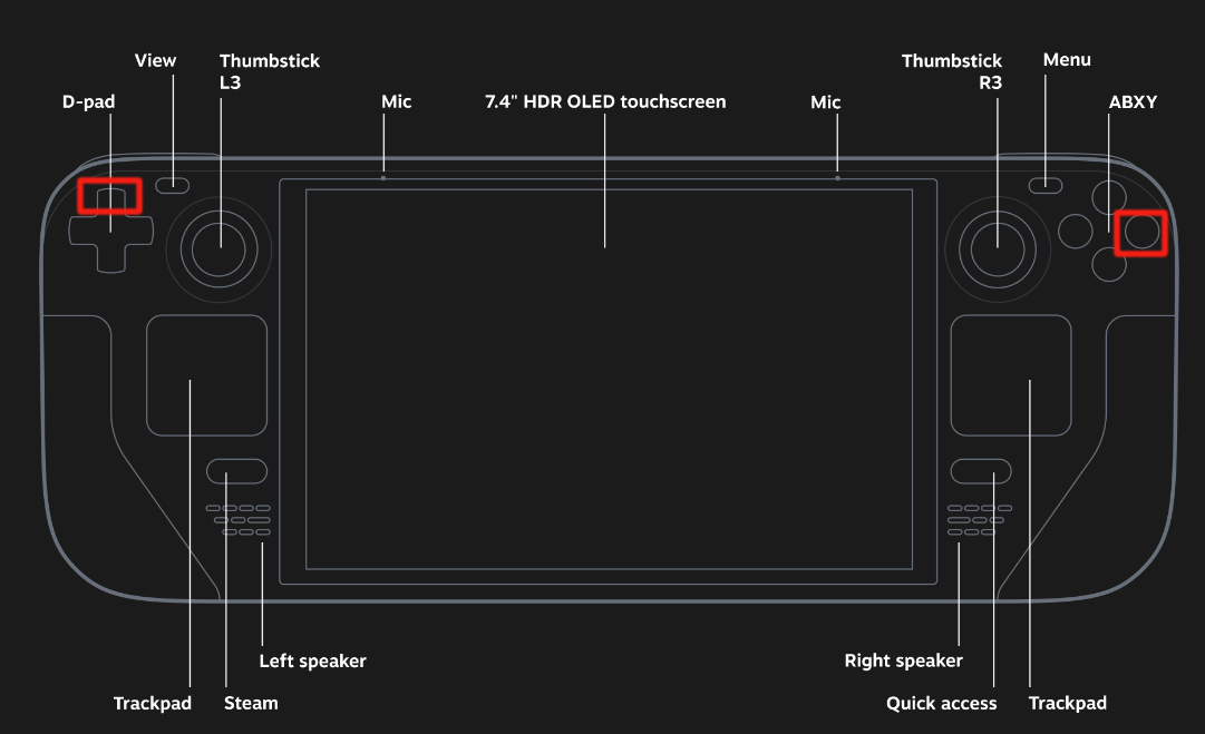

  1. Press A + Up arrow to restart the Husky driver.

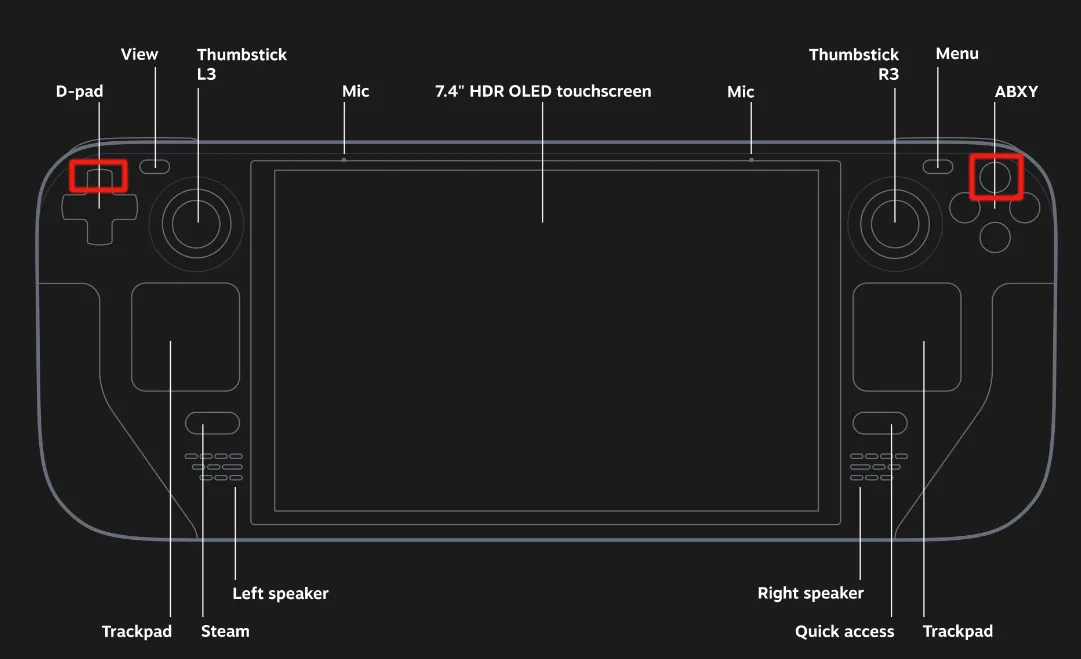

  2. Use B + Up arrow to activate TCP tunnel 2.

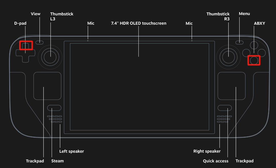

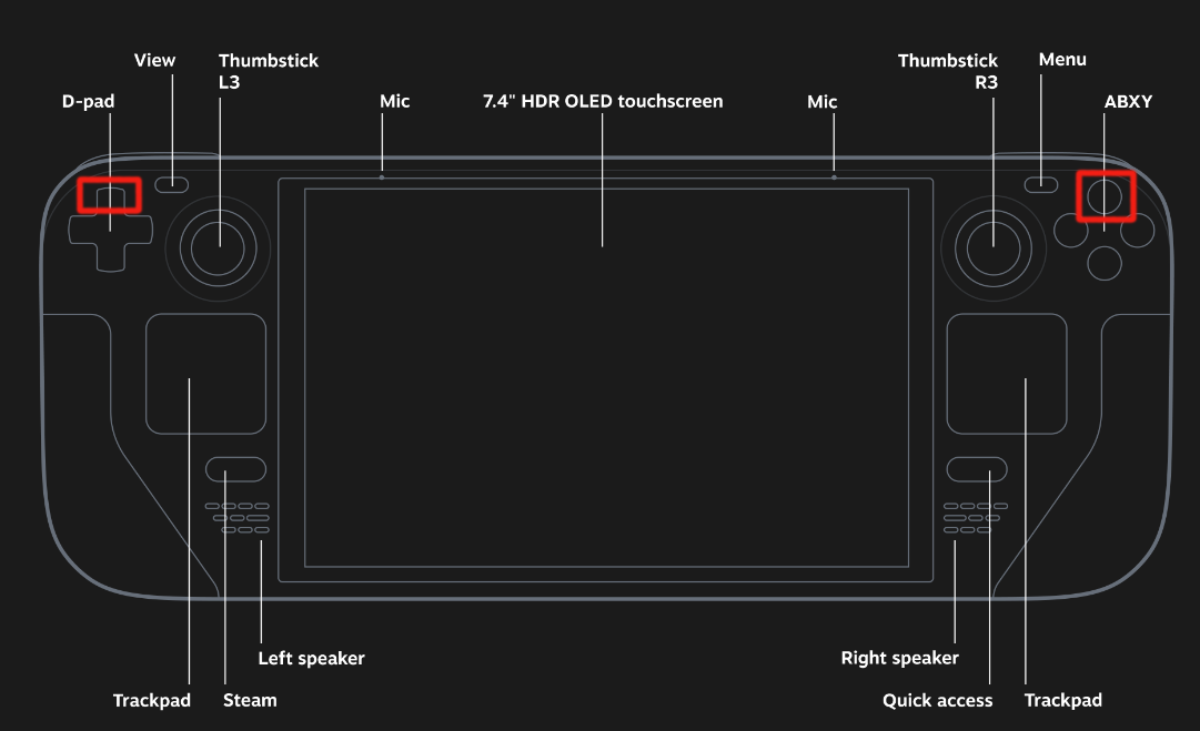

  3. Press Y + Up arrow to activate the ZED2i Depth camera.

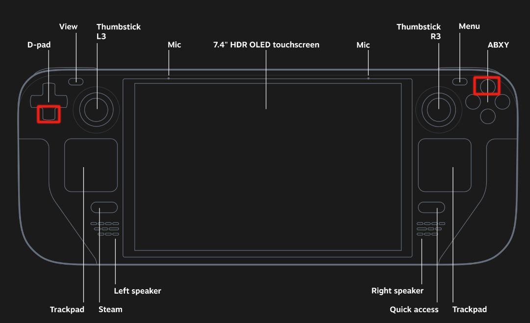

  4. Use Y + Down arrow to deactivate the ZED2i Depth camera.

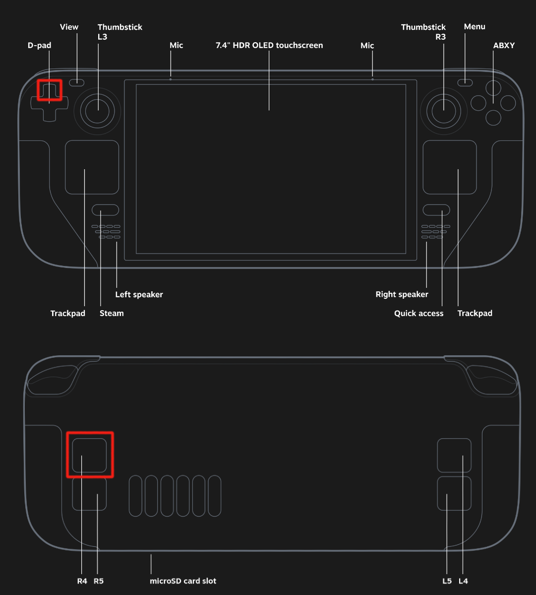

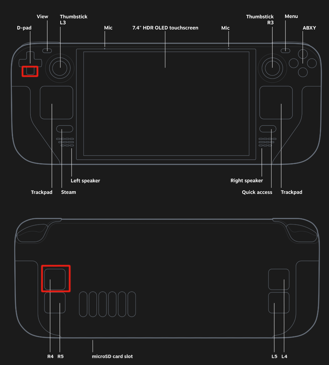

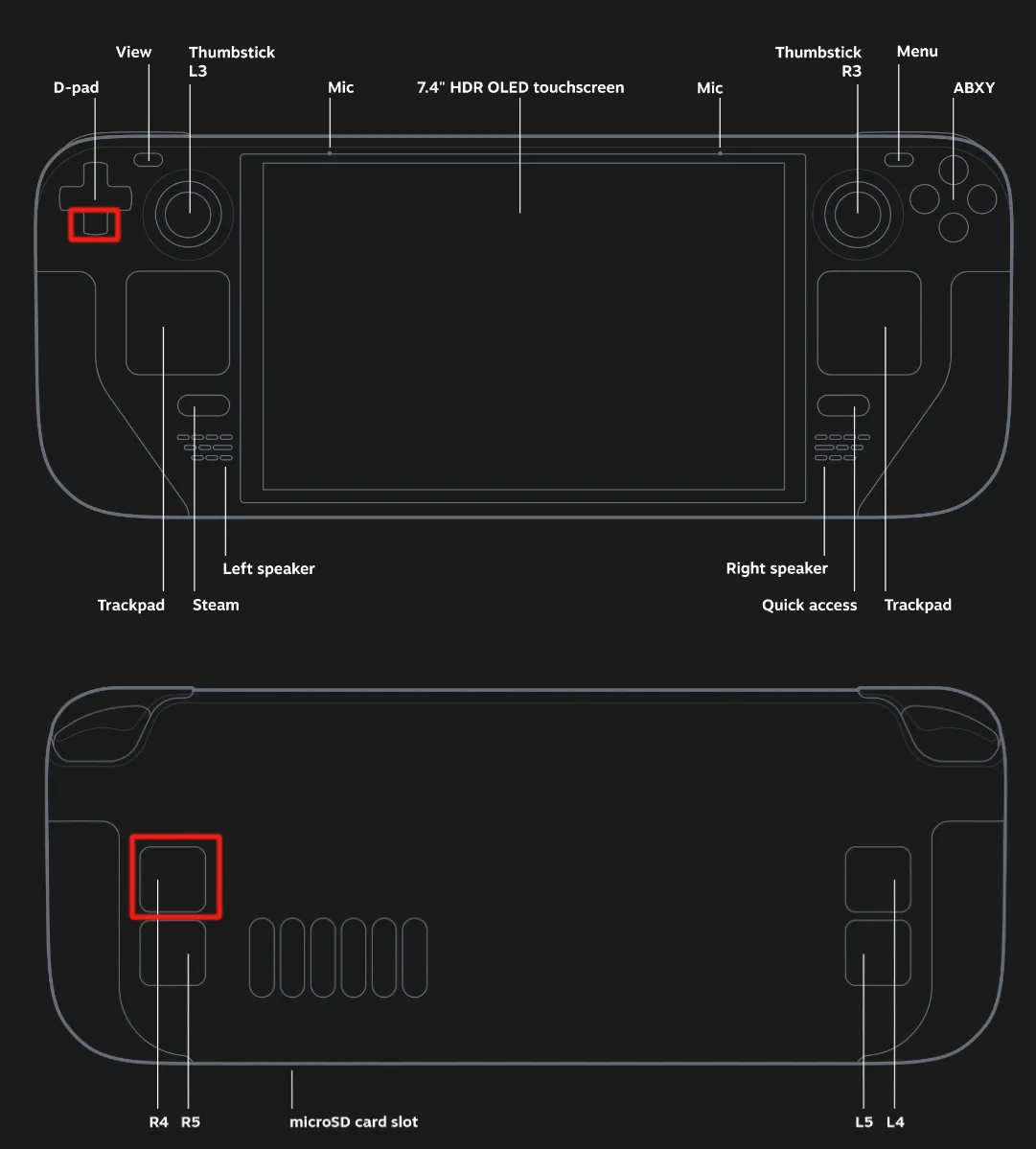

  5. Press R4 + Up arrow to activate the Ouster Lidar.
  6. Use R4 + Down arrow to deactivate the Ouster Lidar.

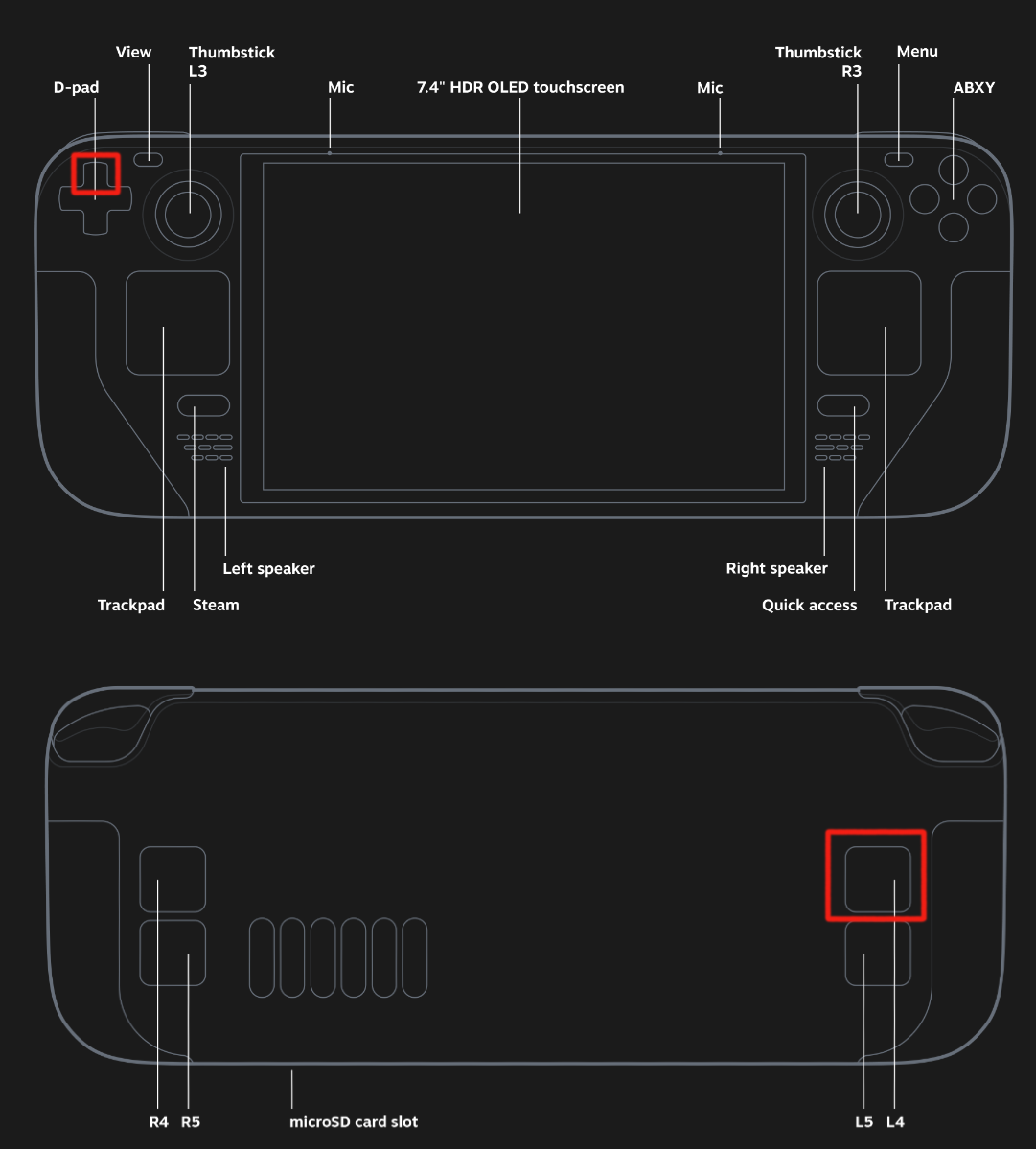

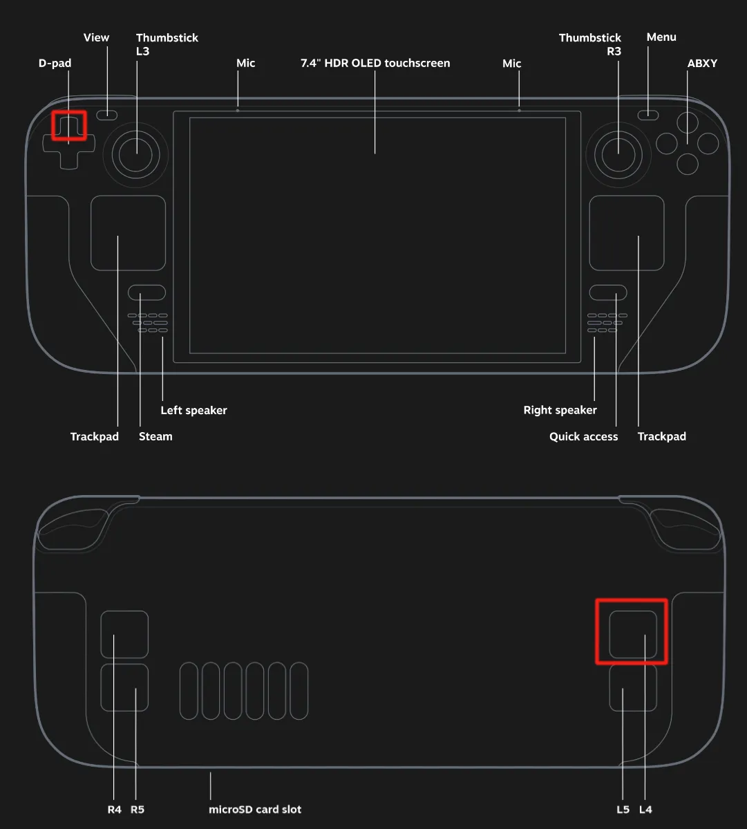

  7. Press L4 + Up arrow to activate the Fixposition GPS.
  8. Use L4 + Down arrow to deactivate the Fixposition GPS.
