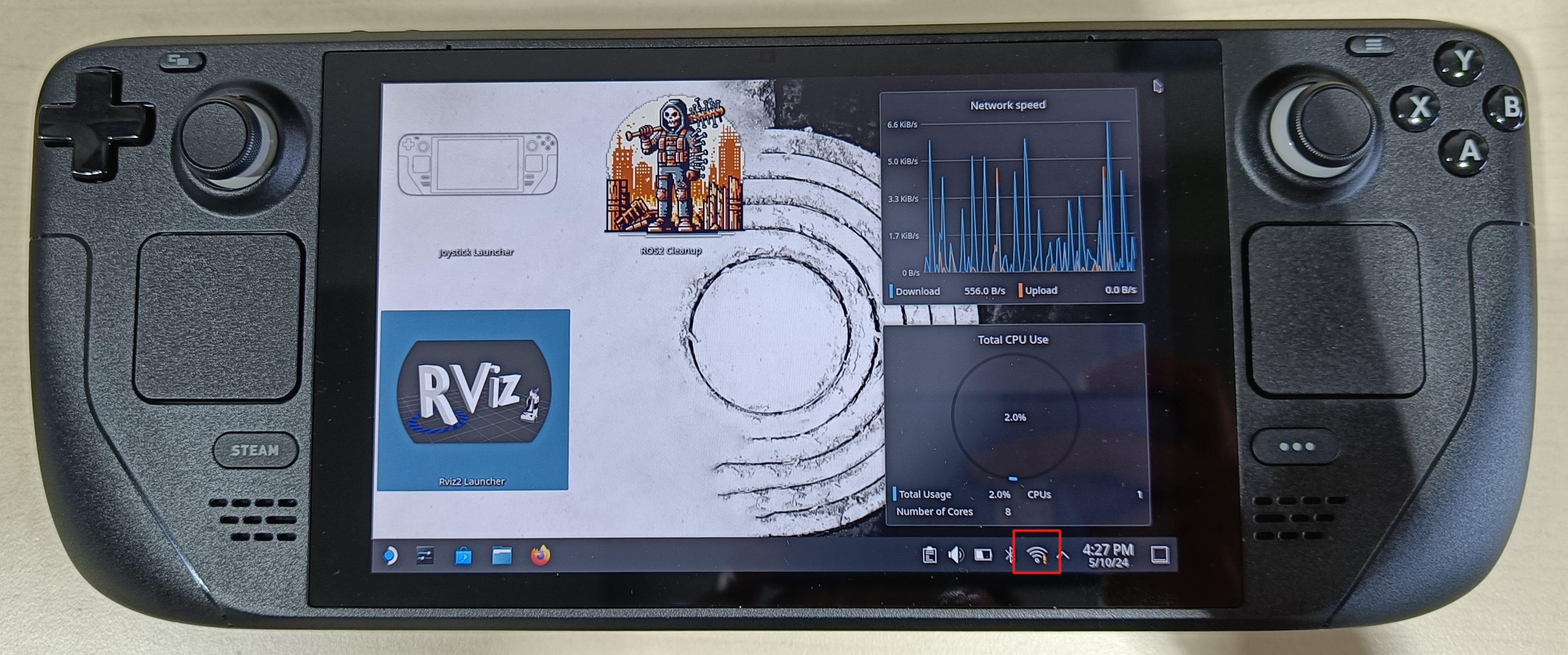

  1. Confirm that the Steam Deck is connected to the robot’s WiFi access point.
    _images/sd33.webp
    ■ This process is automated.

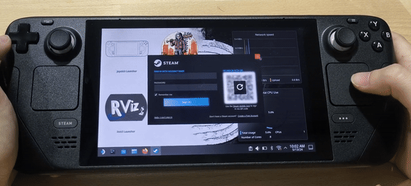

    ■ Press and hold the button for 3 seconds until you feel the controller vibrate, then repeat the action for 3 seconds. This step is necessary to reactivate the mouse function on the Steam Deck.

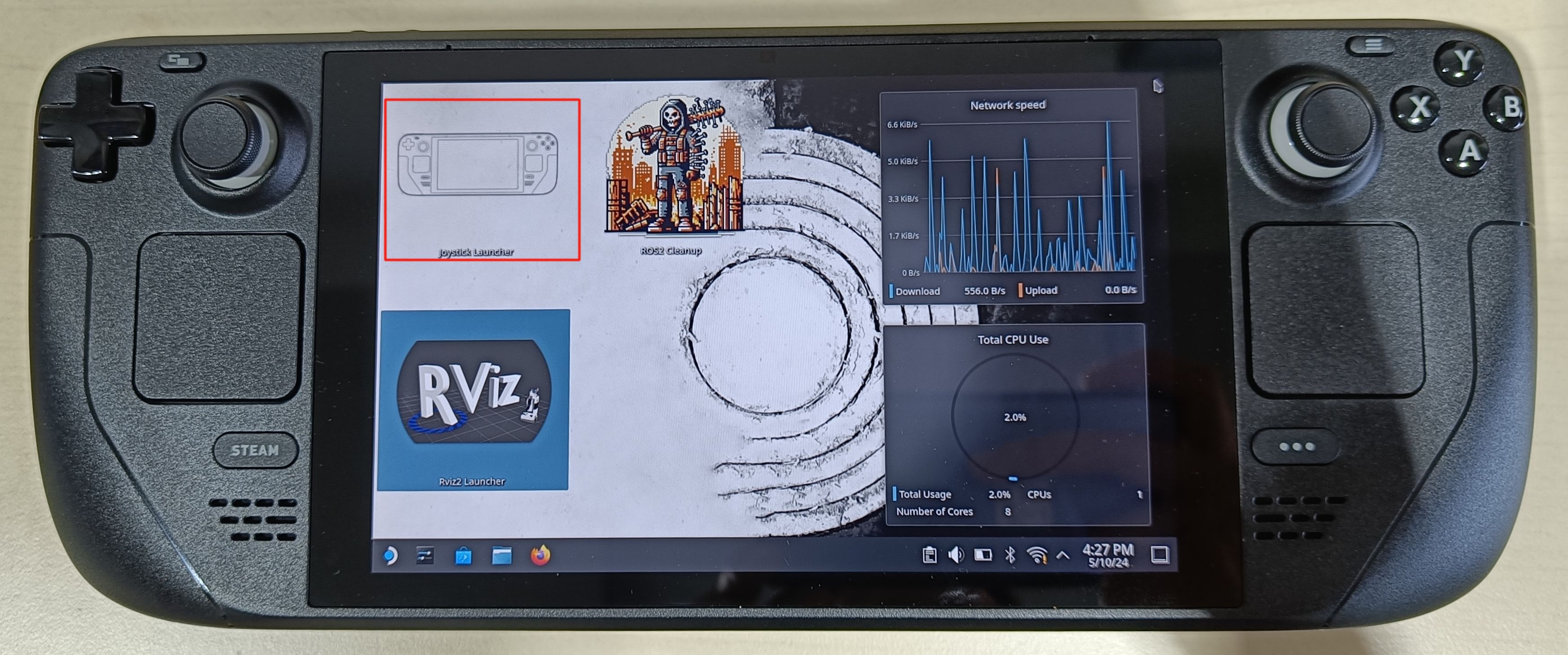

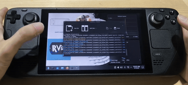

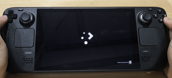

  3. Simply tap the Joystick Launcher icon on the screen to activate the controller for the robot.
    _images/sd34.webp
    _images/sd1.gif
    ■ Avoid opening multiple instances of the Joystick Launcher to prevent the generation of unwanted nodes.

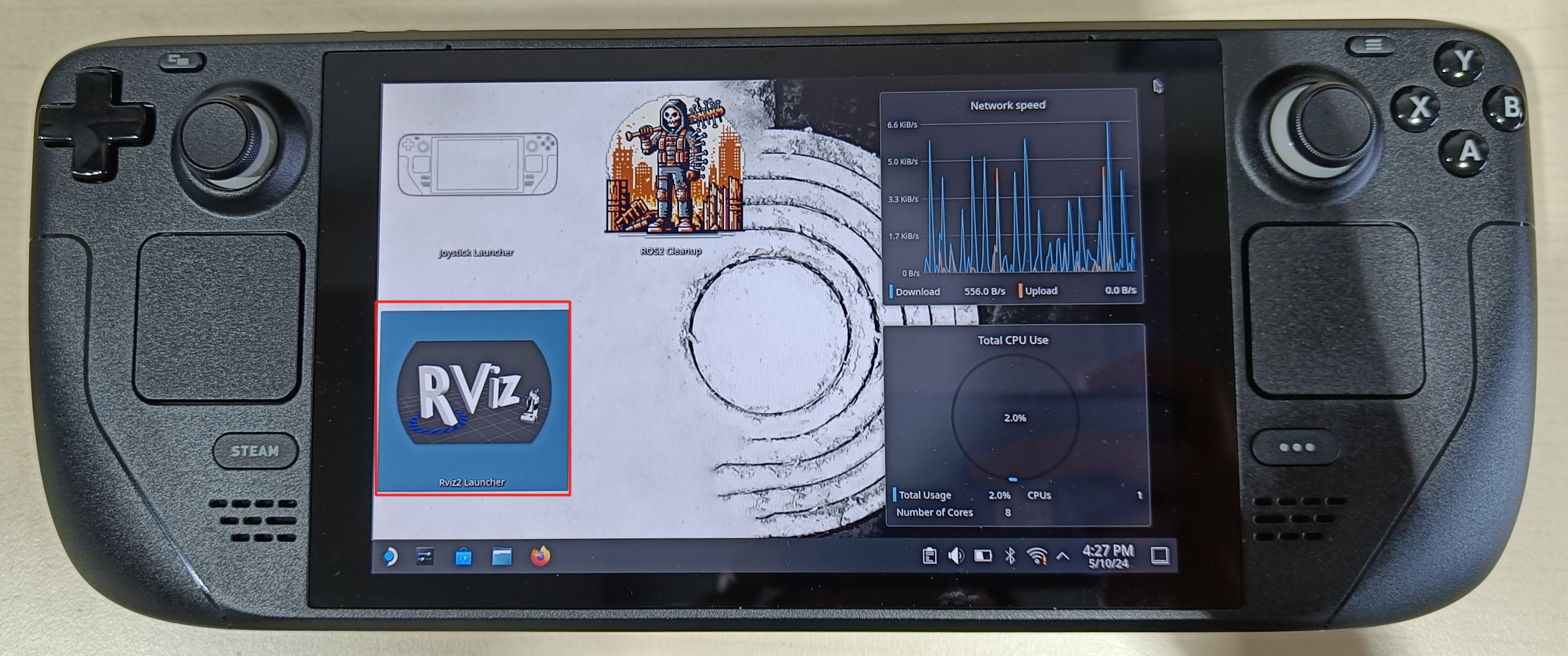

  4. Tap once on the RViz2 Launcher icon to visualize the robot.
